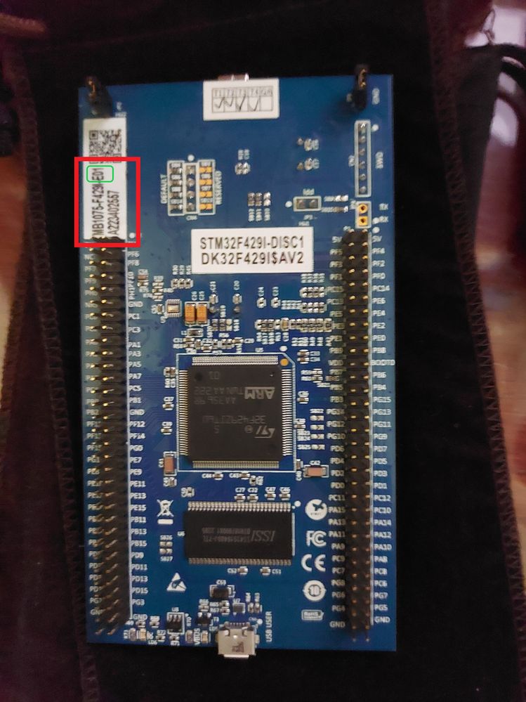

_legacyfs_online_stmicro_images_0693W00000binnXQAQ.pngGood morning and thank you! How do I see the REV of the card? I don't see any indication on the circuit board.
Aldo
Hi Alann ,
as mentioned on the picture below , your board is STM32F429I-Discovery RevE.
_legacyfs_online_stmicro_images_0693W00000binqCQAQ.pngBr
Moez
