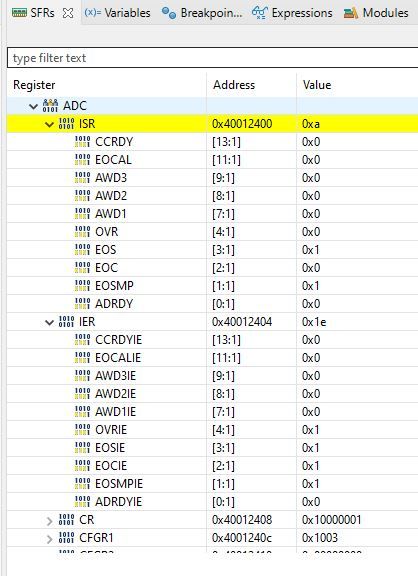

Wrong indexes are caused by ADC overrun happening because of interference by the debugger. When that happens, the correct action is:
  1. Stop the ADC with ADSTP.
  2. Disable the DMA channel.
  3. Reconfigure the CNDTR for DMA channel.
  4. Enable the DMA channel.
  5. Start the ADC with ADSTART.
I thought this might be the answer but I don't see any overrun isr's flags being set. Just End of Sequence and End of Sample flags.
Debugger may be intrusive simply by reading the registers. I don't know the minutiae of 'G0 ADC and maybe it's not a problem here; but not reading them by debugger while it's running means to stay on the safe side.
DMA is set as circular or you restart it in some way? And how exactly is ADC clocked and triggered?​
You haven't answered questions from my first post either.
Sounds unlikely that DMA would be related to unexpected readout, IMO.
