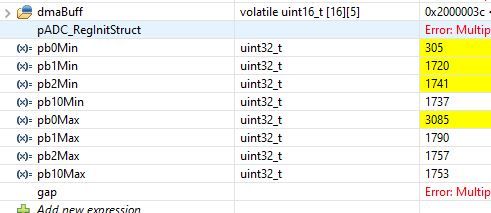

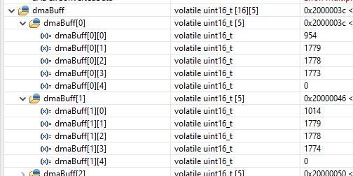

We are bringing up our new board and using ADC1 to DMA PB0, PB1, PB2 and PB10 pin readings into memory. The actual level on the pins is ~1.358 volts and the DMA data from the pins seen by software are 1775 to 1786. The ADC is set to 12 bits so these readings are showing 1.43 to 1.439 volts. This is an error of 72mVolts which seems excessive.
The initial code by Cube was set to use Low Level drivers calls.The ADC is set to use 4 ranks and 19 cycle samples. The Cube code also has run a ADC calibrate so we are at a loss to pinpoint why the four ADC pin readings are so far off.

DMA issue was the incorrect channels used in LL_ADC_REG_SetSequencerChAdd() call. After hardware modifications the pinouts changed and we modified the LL_ADC_REG_SetSequencerChannels() call but missed the LL_ADC_REG_SetSequencerChAdd().
LL_ADC_REG_SetSequencerChAdd(ADC1, LL_ADC_CHANNEL_8 | LL_ADC_CHANNEL_9 | LL_ADC_CHANNEL_10| LL_ADC_CHANNEL_11);
DMA buffer to ADC channel alignment is fixed.
ADC issue appears to be noise on the line during sampling. All original ADC sample time settings were for 19 clock cycles(LL_ADC_SAMPLINGTIME_19CYCLES_5.) After changing the sampling down to 3 clock cycles(LL_ADC_SAMPLINGTIME_3CYCLES_5) the sample levels dropped:
The 1720 minimum value of PB1 is 1.386 volts, which is very close to the expected 1.358 volts. We do see a small amount of noise on those pins which must be driving the ADC level up during a 19 clock cycle sample.
I gave credit to the "Borg" avatar member for pointing out sample and hold time settings. Thank you for all the comments/suggestions in resolving this issue.
