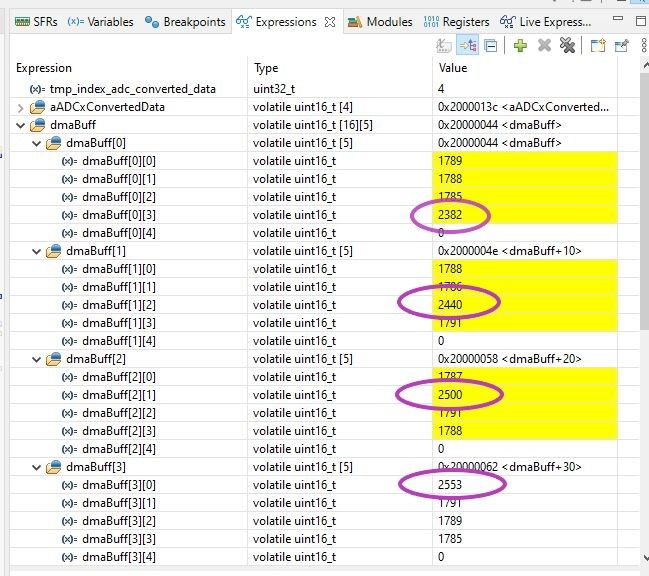

We are bringing up our new board and using ADC1 to DMA PB0, PB1, PB2 and PB10 pin readings into memory. The actual level on the pins is ~1.358 volts and the DMA data from the pins seen by software are 1775 to 1786. The ADC is set to 12 bits so these readings are showing 1.43 to 1.439 volts. This is an error of 72mVolts which seems excessive.
The initial code by Cube was set to use Low Level drivers calls.The ADC is set to use 4 ranks and 19 cycle samples. The Cube code also has run a ADC calibrate so we are at a loss to pinpoint why the four ADC pin readings are so far off.

Best answer by S.Ma
Also check if sample and hold time is ok and the adc frequency is within tolerances.
21 replies

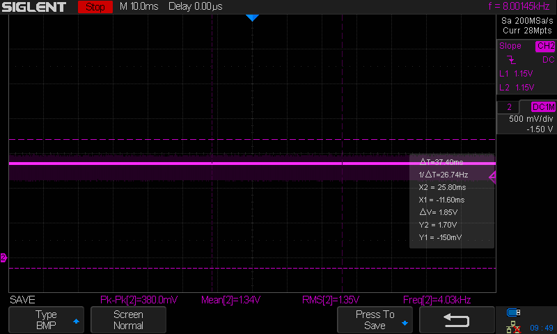

Andrew Neil
July 26, 2022
"The actual level on the pins is ~1.358 volts"
How have you confirmed that?
CharlieMangold
Senior
July 26, 2022
Multi-meter.
Andrew Neil
July 26, 2022
You're sure the meter is calibrated? The 72 mV error is ~ 5.5%
And you're measuring at the ADC pins - both ground and input?
Have you checked with an oscilloscope that there isn't noise that would be missed by a meter?
CharlieMangold
Senior
July 26, 2022

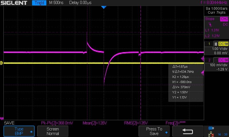

0693W00000QMCPzQAP.jpgTook a scope reading and there is a small amount of noise but the high/low readings don't fall into what the scope is showing. Scope is showing a 1.35volt mean and my 1msec samples min/max readings are 1775/1786 which equates to 1.43065/1.439516.
waclawek.jan
July 26, 2022
What exactly is voltage on VREF+ (VDDA)? Do you perform ADC calibration as outlined in RM? What is the VREF channel really [edit autocorrect correction] readout [/edit] and what is the calibration value for that channel in the system memory?
JW​

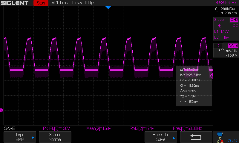

We do a ADC calibration that the Cube generated code performs after the ADC and DMA channel are set up. We have tried shorter and longer sample periods but it has minimal effect. We have some type of setup issue with the ADC to DMA. Each of the ADC pins can have one of four signals present based a two dip switch settings. With both switches off(0-0) you get this:
0693W00000QMHbRQAX.bmpSwitch setting 1-0 you get this:
0693W00000QMHc0QAH.bmpBy finding the min and max on a particular pin, you can derive the dip switch settings. Late yesterday I noticed that when I changed the dip switch settings on PB0, every DMA buffer was being changed. Here is a debug capture of the DMA buffers where you can see the PB0 value walking across different indexes when it should be staying in the same DMA one. We must have something incorrect in the setup:
