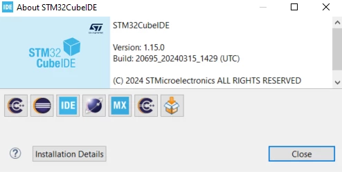

STM32CubeIDE update with the version 1.15.0
The last update of CubeIDE is like below:

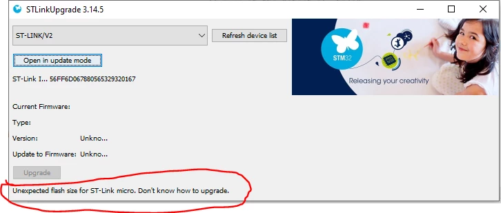

After this CubeIDE update, the FW update is required for ST_Link/V2 Programmer

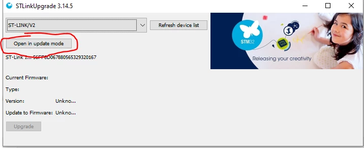

I pressed the "Open in update mode" button.
The error bellow is present now, like bellow:
What can I do to solve this aspect?
I can't use the programmer to program the micro controller or to make a FW debug.
Thanks in advanced
Constantin
P.S.
before of this last update, the mentioned warning was not present. I used the same FW code. And the ST_Link/V2 FW update was working every time when the CubeIDE requested for it
The ST_Link/V2 programmer is OK. I use it on the other PC and I test it also using ST_Link Utility and on this tool the FW update is working and the controller can be programmed.

    Try to update your ST-Link FW with the STSW-LINK007 ST-Link firmware updater application.

    Mar 21, 2024 5:04 PM UTC
    Ok, it's working now. Thanks
    mƎALLEm
    Mar 22, 2024 6:06 AM UTC
    Note that the proposed solution is just a workaround. The issue need to be fixed in CubeIDE.
