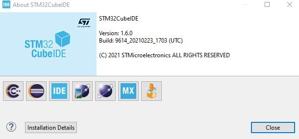

‎2021-03-02 1:52 PM
Late package which is same as early one according @mattias norlander​ is:
Just rely on Help > About in case you need to be comfortable about.
My snapshot is based on fresh install I've done relying on www.st.com today
