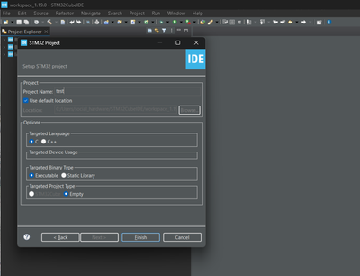

stm32 targeted project type is empty and its not generating .ioc file
_kalpesh

Hi Im trying to generate new project with CUBE IDE 1.13 which was working fine this morning but somehow its not generating .ioc file anymore when i searched it says FPU not initialized & generates only files which are present in the second picture
plz help me on this

I faced this issue in v1.16.0, where project type "STM32Cube" was greyed out. When I upgraded to v1.19.0, this issue was resolved initially. However, today, I have the same issue showing up again.
Here are the screenshots -
