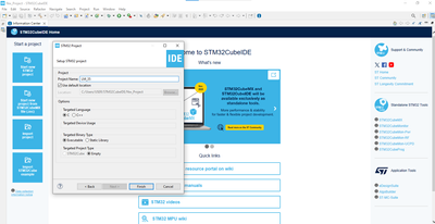

Hi Im trying to generate new project with CUBE IDE 1.13 which was working fine this morning but somehow its not generating .ioc file anymore when i searched it says FPU not initialized & generates only files which are present in the second picture
plz help me on this

I updated to 1.19 and am still experiencing the issue. STM32Cube is greyed out.

I have the same issue. Upgrading to 1.19.0 did not help. The cubeMX project option remains blanked out. It worked fine until recently when I discovered 1.18 to have this issue. I did a clean re-install and still.
Same, I also reinstalled STM32 IDE 1.19 twice, and tried 1.18 once, with
the same result.

It's probably already been said, but one way around this is to use the standalone CubeMX tool to generate the .ioc. Then in STM32CubeProgrammer, you select the option: STM32 Project from an Existing STM32CubeMX Configuration File (.ioc).
This solved my problem with 1.19.0 and I guess it also solves it for earlier versions.
However, I got the same problem again, and the same solution works. I think there's something that's causing one of those user settings to get corrupted. I've been reorganizing some projects by renaming them, deleting them from the IDE, renaming directories and re-importing and then creating a new project to start clean with some new idea. I was doing the same thing when I got the problem the first time.
It could have nothing to do with it. Another thing I noticed is that while creating a new project, it started scanning for updates, maybe if it finds some update in the middle of creating a new project, it corrupts the settings, don't know.
This time I only deleted the .stmcufinder directory in user's home and it works agin. So there might be something wrong with the mcufinder plugin.
Oh, I see. This is what the solution from ST states and to set no-auto refresh to the firmware updater.
The problem has again arrived in latest 1.19.0. How many times do we need to reinstall the software just to open simple IDE
Hello, I was dealing with the same problem...then I upgraded to version 1.19.0...As expected it worked..
