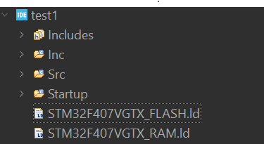

Hi Im trying to generate new project with CUBE IDE 1.13 which was working fine this morning but somehow its not generating .ioc file anymore when i searched it says FPU not initialized & generates only files which are present in the second picture
plz help me on this

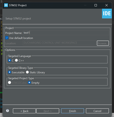

The stm32CUBE option is not selectable its grey
checked the correct version on the PC its present and working how to fix this

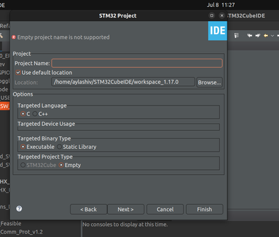

I have the same issue, The Targeted Project type is by default selecting to "Empty", and STM32cube option greyed out.

July 8, 2025
@_kalpesh Hey, I was facing the same issue with STM32CubeIDE version 1.18. One other comment in this thread has mentioned it working with version 1.19. So I tried updating my cube version to 1.19 and now it all works fine(the STM32cube project type is selectable and the ioc file is being generated now). Just update your cube version to the latest.
