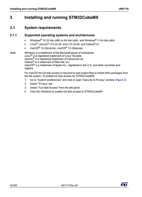

Hello @YamiTheWitch
Based on UM1718 :3.1.1 Supported operating systems and architectures
CubeMX officially supports Ubuntu LTS 22.04, 24.04, and Fedora 41
 Nobara 42 is not officially supported by STM32CubeMX 6.15.0.
For best results, use a supported operating system such as Fedora 41 or Ubuntu LTS 22.04/24.04 in a virtual machine or container.
THX
Ghofrane

Hello @YamiTheWitch
THX
Ghofrane
