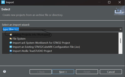

sir what i would suggest is,
create a new workspace with your current IDE version where you directly copy your current projects and import them directly.
the way you are suggesting is quiet messy, i have tried it few days ago it didn't work for me
