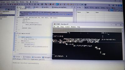

I'm trying retarget printf. My uart_write function is working correctly and i'm able to see character on Teraterm.
But when i try to use printf it is not working. i even tried semihosting to execute printf but it fails. i'm attaching the screenshots -
Disassembly of the code stucks at "bkpt 0x00ab" -
any solution for this problem?

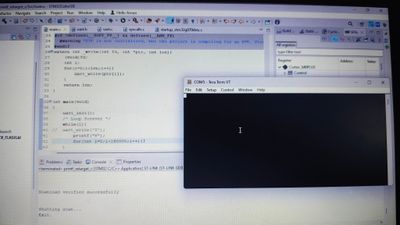

Tried with the C project as well it's not working.
It printed few lines then threw some garbage. I retried debugging but now nothing displayed on terminal.
Do I need to increase baud rate from 9600 to 115200? Because it's taking time to print.

Because I stopped semihosting in this new C project it is not getting stuck at BKPT.
Note - It's not getting stuck at BKPT even in C++ project if not using semihosting.

"Time to print" i mean to say, it's stuck in buffer before displaying in the terminal. Like it takes couple of minutes to display in terminal when I'm using printf.
‎2024-09-17 5:24 AM
As noted, that's expected behaviour for stdout (used implicitly by printf)
From the other threads, you should be able to disable the buffering with:
setbuf( stdout, NULL );
https://en.cppreference.com/w/c/io/setbuf
Or use stderr
Or just send a newline.
‎2024-09-17 10:12 PM
For C++ we need to add the extern "C"..
Thanks for the suggestions.!
