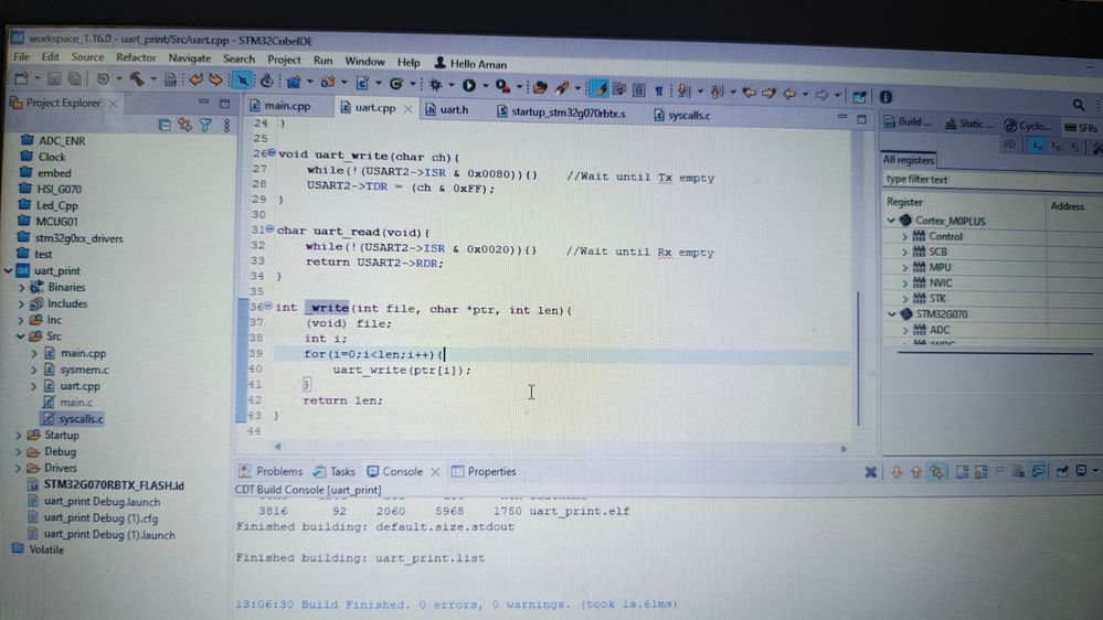

I'm trying retarget printf. My uart_write function is working correctly and i'm able to see character on Teraterm.

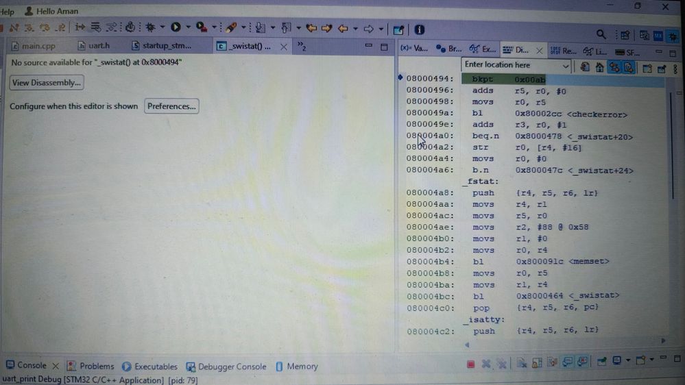

But when i try to use printf it is not working. i even tried semihosting to execute printf but it fails. i'm attaching the screenshots -
any solution for this problem?

    Hi @KDJEM.1 ,
    I appreciate your comment. But the link provides the way to retarget HAL library UART, which i see is working fine.
    But here I'm using CMSIS library to write my UART driver. And here it is not working.

    It really shouldn't make any difference - they all just end up writing to the UART.
    If you're hitting a BKPT instruction, that suggests you're configured for semihosting - you don't want that.

    AVerm.4
    AVerm.4Author
    September 17, 2024
    @Andrew Neil sorry for that. I'm not using a personal computer rather a corporate one were we have limited access to file sharing.!
    Andrew Neil
    September 17, 2024
    Presumably, the screenshots you shared show your semihosting attempt - as this works via the BKPT instruction?
