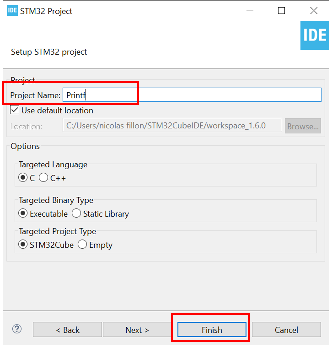

  1. Give a name to the project
  • For this example, the project name is “Printf”.
