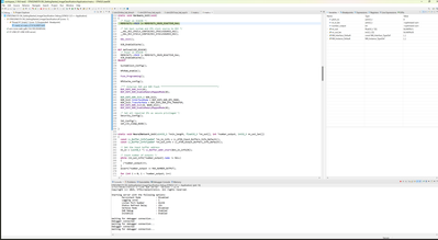

Hello, I'm trying to set the debug configuration of my project, but I cannot open the debug file under C/C++ Application. Besides, running this project was not successful either.
I have tried switching workspace and uninstalling IDE, but neither worked.

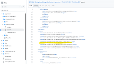

I used the example project "STM32N6570-DK_GettingStarted_ImageClassification", as shown in the picture. The link is here: https://github.com/STMicroelectronics/stm32ai-modelzoo-services/tree/main
and I only generated the network code following this post without making any changes https://community.st.com/t5/stm32-mcus/how-to-run-ai-models-from-model-zoo-on-stm32n6/ta-p/814254
The whole project can be built correctly and .elf executable file exists in the debug file. I already tried deleting the configuration but the error persists.
Fortunately, I found a way to avoid this problem. Instead of running the project, I used the bin file generated by the project build, and programmed this file directly onto the development board using STM32Programmer at address 0x70100000.

Hello @Levy-hy
As a workaround, try removing the following line from your .project file:
<nature>com.st.stm32cube.ide.mcu.MCUAppSProjectNature</nature>
You will be able to debug your project successfully.
