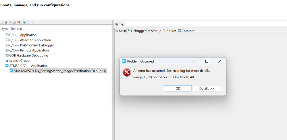

"Range [0,-1) out of bounds for length 48" trying to open Debug Configuration

Hello, I'm trying to set the debug configuration of my project, but I cannot open the debug file under C/C++ Application. Besides, running this project was not successful either.
I have tried switching workspace and uninstalling IDE, but neither worked.
Can anyone help me solve my problem? Thank you very much.

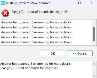

Did you try pressing the 'Details' button?
The message says, "Out of bounds for length 48".
The name of your Debug Configuration is very long* - maybe it's too long?
Maybe try just shortening the name?
PS:
* The name certainly is over 48 characters!
Levy-hyAuthor
July 29, 2025
Details are the same. I tired to rename the project to make its name shorter, but it didn't work either.
Then I opened another project, and found its run configuration back to normal. So I assume the problem lies in the project. But the project is the example AI demo project of STM32N6 and I'm stuck here:(

August 19, 2025
Hello @Levy-hy
As a workaround, try removing the following line from your .project file:
<nature>com.st.stm32cube.ide.mcu.MCUAppSProjectNature</nature>
You will be able to debug your project successfully.
