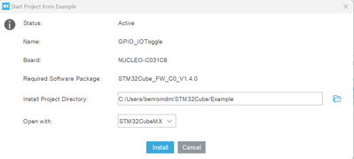

When I open the official example using the example selector, CubeMX cannot display the graphical configuration of that example. I would like to know if it is possible to display the graphical configuration of the example in CubeMX. Thank you very much, because that would make learning much easier.

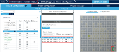

Hello @stm64 ,
STM32CubeMX should display the GPIO Settings such as the case with Nucleo-H7S3L8.
An internal ticket has been raised to the dedicated team (Ticket Number:  225239).
To activate a LED on NUCLEO-C031C6, simply configure PA5 in push-pull output mode and HCLK at 48 MHz, as indicated in the Example Readme File.

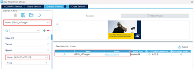

Hello @stm64 ,
Let me thank you for your post.
For more investigation, could you please provide which example are you using.
Thanks.
Mahmoud
GPIO_IOToggle NUCLEO-C031C6  version:6.12.0

Hello @stm64,
Further to your comment, STM32CubeMX 6.16.1 provides an example GPIO_IOToggle with an Ioc.File.
I suggest that you select it and click on start project.
You can access also to the Example under the firmware path:
C:\Users\_\STM32Cube\Repository\STM32Cube_FW_C0_V1.4.0\Projects\NUCLEO C031C6\Examples\GPIO\GPIO_IOToggle
I will be waiting for your feedback.
Thanks.
Mahmoud

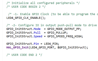

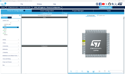

This is how I did it. After clicking the steps above, CubeMX opened automatically. As shown in the image below, the CubeMX interface does not display the GPIO configuration.
Although when I import it into cubeIDE later, I can see the GPIO_IOToggle code and the function works normally.
I want to see how the GPIO_IOToggle example is configured graphically in cubeMX, but I can't see it here.
Thanks.
There's no way to change how the example is set up, but you can change a pin to be GPIO_Output and it will be initialized as such in the code.
Configuration of the pin is done in user code within the example, not from within STM32CubeMX.

I know what happened. The GPIO_IOToggle and GPIO_EXIT example files for NUCLEO-C031C6 are corrupted, while the other examples can display the graphical configuration correctly in cubeMX.
