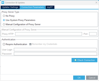

I had a same problem. I tried to @Peter BENSCH 's solutions. Here is what i did;
Active Provider : " Manuel "
and st select automatically " http / https / socks " and "local hosts / 127. ...... "
it worked.

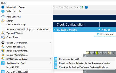

I solved the problem. Below is what I did, not sure which part works
1. I logged into myST. My version 1.18.1, it's located at Help -> STM32Cube updates -> Connection to myST

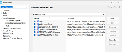

2. I also followed instruction from ChatGPT below:
In "Window -> Preference -> Available Software Sites", added
https://www.st.com/stm32cubeide/updates
https://www.st.com/stm32cubeide/updates/stm32cubeide-repository

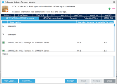

3. In Help -> STM32 Cube updates -> Embedded Software Package Manager, click 'Refresh' and found the packages I need.

reeeeeeeee
I switched to "Use System Proxy Parameters" and solved this problem
