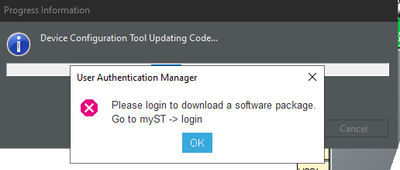

I just updated from 1.12.0 to 1.13.0 and now when i save changes it asks me to sign in to mySt to download a software package.
When i try to login to my ST i get this error:
I am on my work network, not sure if that matters. My internet is working fine with everything else but the STMCubeIDE

    Welcome @cmendi, to the community!
    STM32CubeIDE uses the network settings under Window > Preferences > Network Connections. There you can choose between:
    • Direct (without proxy)
    • Manual (uses dedicated proxy settings)
    • Native (dynamic host)
    For Manual you have to enter your credentials if you are working over a VPN or a proxy. Please try if you can get it to work with one of these settings?

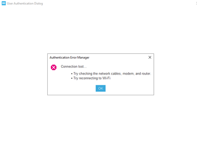

    Hello - first post,
    I am new to ST microcontrollers but not in general. Just purchased a STM32H745i discovery board and plugged in Micro USB via laptop and nothing happens but red LED glowing on back - I believe COM light. This is disappointing.
    Also, after watching a couple videos on CubeIDE getting started, downloaded IDE and tried to create project - I am affected by same bug and cannot authenticate to download package. It will flash either blank screens "Authentication Error Manager" or show connection lost like others have reported. This is also disappointing. So I have an IDE that is useless and a board that does nothing.
    I did check Network Settings under Preferences and only HTTP is checked.
    This is BS.

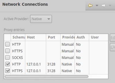

    same here! CubeIDE is used behind corporate proxy under Linux with cntlm (for authentication). This works fine in general.
    Proxy ist configured in IDE as:
    The Connection check is "green" under STM32Cube-> Firmware updater:
    Below this successful check, I see a message with some "recommendations" to do some refreshes. These all work fine! E.G. run "Refresh" from Help->Embedded Software Package Manager. I can also monitor in cntlm log file as multiple .pack files are accessed on the web. (I must admit, that I also got the package manager stuck by explicitly selecting STM32H5 MCU Package 1.1.0 and clicking "Install").

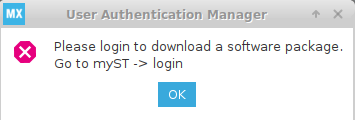

    When I create a new STM32 project the wizard finally asks me to Login to myST:
    When I use myST -> Login from Eclipse menu I get the "Connection lost..." message as described in this thread. So I would say internet access works, but the myST login is the problem.Hope this helps.

    I have to connect to the internet via proxy. So my options are "Manual" and "Native". Native seems to use the system settings. Under Linux they come from http_proxy and https_proxy. On my system they point to a local running cntlm instance that does the authentication for my local application (e.g. browser). But STM32Cube IDE seems to have problems with cntlm. So I switch to "Manual" and had to enter proxy settings manually - including credentials. This works, but it is not nice to have the credentials being entered inside an application. cntlm would be nice. No idea what makes the IDE unhappy with this.

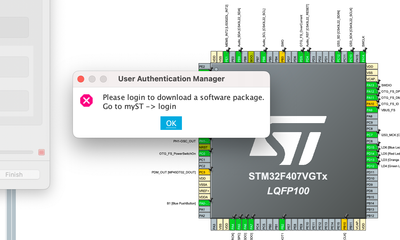

    Visitor II
    May 14, 2024
    Same here on macOS Sonoma 14.4.1. Even tried saving my username and password in Updater settings > connection parameters
    Had to download & install my MCU packages manually.
    Why does it need to behind a login and is it not properly tested? Why not save your developers & users a lot of headaches and write native SW instead of trying to get something to work with Java?
