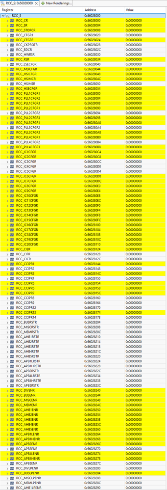

@FBL Is it correct that so many registers (see image, marked as yellow) has been cleared after execution of
  /* Core Soft Reset */
  USBx->GRSTCTL |= USB_OTG_GRSTCTL_CSRST;

@FBL
No, it is cleared after call of
which is inside
USB_CoreReset()
