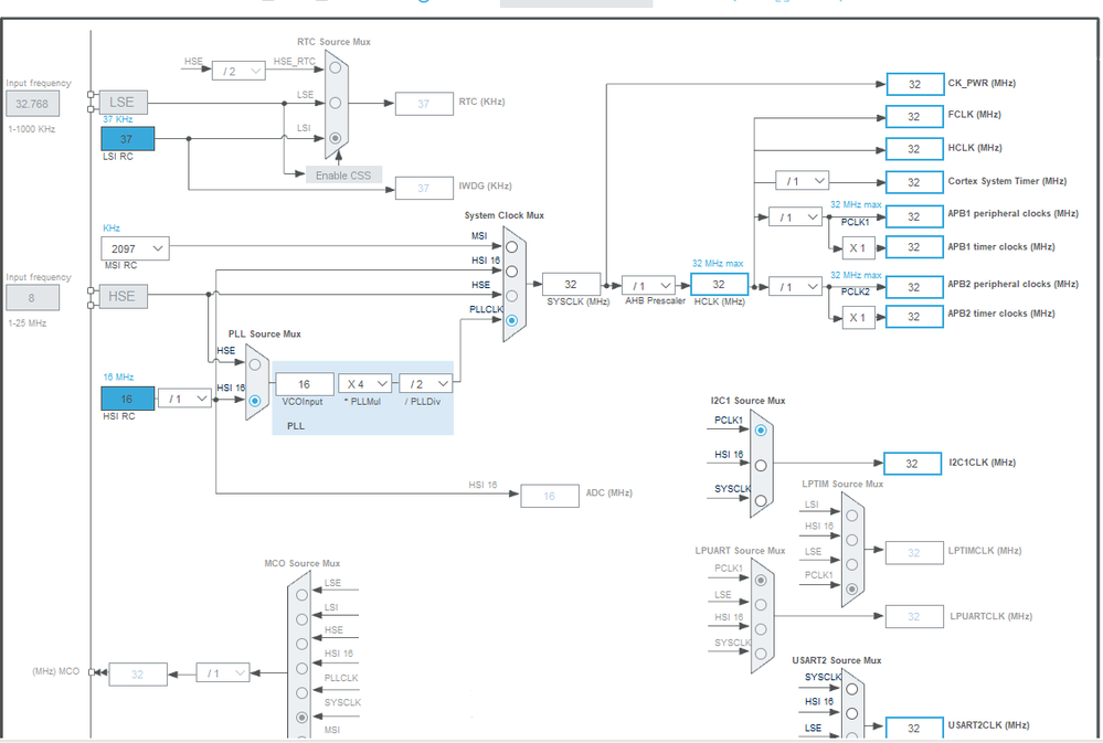

STM32CubeMX clock configuration settings (MCU works at maximum 32 MHz):

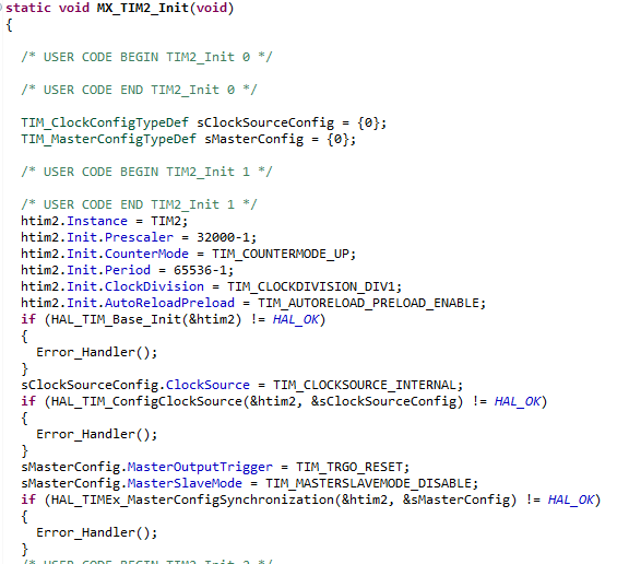

Generated Timer init function:
The maximum period I can enter is 65 536 ms (2^16) which is 65.536 seconds. If I enter for example 70 000 then timer interrupts every 5 seconds.
How could I set period to 10 minutes (600 000 ms)?

Set it to 1 minute (60 seconds), and in the interrupt service routine (ISR) count to 10.
But if I use counting, it will act like delay which results in blocking the program. In such case period could not be changed during operation.

Is it possible to 'Set the timer's prescaler and ARR so that resulting time is 10 minutes' in my case when using STM32L011 MCU?
No. Other STM32 do have 32-bit timers, but not the 'L0 family. Cosider the other options I've mentioned.
