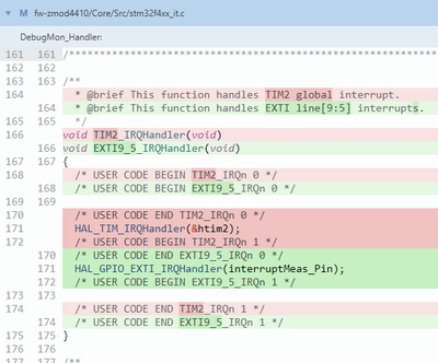

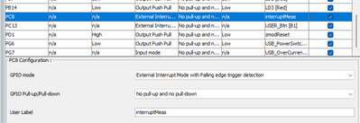

Now I am trying to enable pin PC8 as an external interrupt in order to detect a falling edge:

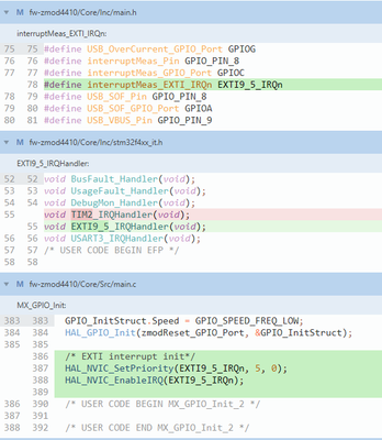

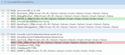

When I generate the code I notice that the TIM2 interrupts is deleted, but I do not understand why. Anyone can help me?
Below I leave the screens of the generated code modifies from git:
Hello @Fin95
You are using STM32CubeMX 6.14.1 , I recommend you to migrate to the latest version of CubeMX 6.16.0 .
When you configure FreeRTOS to use TIM2 as the tick timer (instead of the default SysTick), CubeMX takes control of the TIM2 interrupt for the RTOS kernel. This means: CubeMX will generate the TIM2 interrupt handler (TIM2_IRQHandler) in stm32f4xx_it.c as shown below

Could you please provide your IOC?
THX
Ghofrane
Hi @Ghofrane GSOURI,
of course! I will attach it to this message.
Thanks a lot!
I have installed the new version of CubeMX and from the autogenerated files seems the TIM2 interrupt callback is not even more deleted! ASAP I test the fw, I will check if it works properly and I will reply again to confirm the bugfix.
Thanks for the help.
