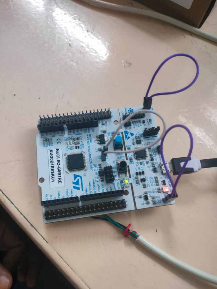

Can you show i pic of the build - esp. the usb connection ?
WhatsApp Image 2024-07-12 at 2.28.30 PM.jpegWhatsApp Image 2024-07-12 at 2.28.30 PM (1).jpeg
Might work. :)
Sure about (2x green wire) DP+/- ? If puzzeled, it never works.
In Cube , setup: have you usb- PD enabled ? Disable, if you did.
