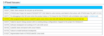

sorry that is not true.
The issue is not solved in 1.14.0 nor in 1.14.1
https://community.st.com/t5/stm32cubeide-mcus/stm32cubeide-1-14-0-gt-old-issue/m-p/612850
They mark a issue as "solved" as soon they generate a ticket.

Just updated to 1.15.1, and this bug is still present. Especially annoying when exiting debug mode to update the code, a random *.s file would open and instead in main, I would start typing in the *.s file.
Please ST, you have been aware of this for years!

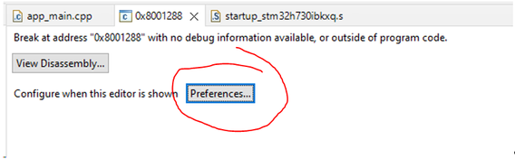

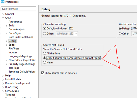

In my case this worked:
I started debug session and 'random' file opened in the editor
I pressed 'Preferences' and
[Window > Preferences > Debug ]
Now, I do not see the 'random' file again.
It is no the 0x800128 file it is the startup*.s file or other random
existing .c files.
If you have only open your "app_main.cpp" and you press "debug"
it opens  the "startup*.s" file or other files. And this is what we talking about.
