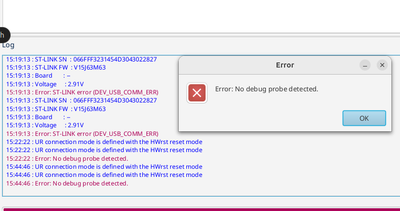

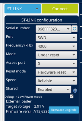

I am having intermittent connectivity issues with my discovery board and the STM32 IDE/Programmer. My system is able to detect the discovery board as it shows up when using the Linux command: lsusb. When launching the CubeProgrammer application it is able to (sometimes) detect the board after configuring the settings properly; after which the board setting are populated (see pic below)
When trying to connect to the board, however, I receive fluctuating error message (see pic below). It is either the DEV_USB_COMM_ERR or the No debug probe detected errors. I am not sure what causes the errors to change but it usually happens when I reset the board because CubeProgrammer was unable to detect it and I am attempting to reestablish the connection (just having the board detected, not pressing the CONNECT button).
The LD1 color is also intermittent and goes from RED to GREEN depending on how the board resets and if it establishes a connection with the computer/CubeProgrammer. The board is receiving 5V through the CN1 (mini-usb) port so it doesn't seem like it's a power issue. The jumpers on CN3 are connected properly. It is worth noting the when the board is detected (but not connected) and I attempt to upgrade the ST-LINK/V2 firmware using the Open in update mode button, the board suddenly disconnects but when I exit out of the firmware upgrade window, it becomes detectable again. Strange behavior.

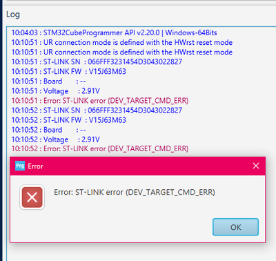

I plugged the board into my Windows computer and although the the detection of the board is still intermittent, when it is detected and I press the Connect button, I receive a new error: DEV_TARGET_CMD_ERR.
While there hasn't been much progress in terms of connecting the board, this seems to suggest more and more that this is a hardware issue instead of a setup/software issue.
If anyone can provide any insight or maybe some experience they have had with this error that would be appreciated.

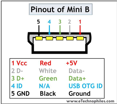

Also thinking it's maybe a cable issue? I'm using an old USB-mini cable that was used to charge a PS3 controller. Think I need to purchase a new one to test out but I've read there are charging cables and data cables but no reliable way to differentiate them. Are there any recommended USB-mini data cables that I could purchase from Best Buy or someplace like that?
Edit: I am using a usb-mini (CN1) cable, not a usb-micro (CN5) cable
MPsyko
I found another USB-Mini cable lying around and the connection is more stable but I still receive the DEV_TARGET_CMD_ERR...
@MPsyko wrote:
I've read there are charging cables and data cables ...
Correct.
@MPsyko wrote:
... but no reliable way to differentiate them.
A charging cable contains only the power wires (+5V, GND) - no data wires:
So a charging cable will never, ever give any data connection at all.
Thanks for the info. I went out and bought a new usb-mini data cable and I am still getting the DEV_TARGET_CMD_ERR error...not really sure what I should try next. I've found a few threads that say this is most likely a hardware issue.
If that's the case, is there anything I can do besides buy a new board???
In your previous screenshot, the target voltage looks a bit low?
Please post a screenshot of what you're now getting.

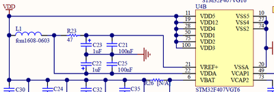

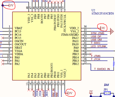

The voltage is a little low but both the U2 and U4 MCU chips input voltage is 3V so having a target voltage of 2.91V seems within the tolerance of both chips.
U2
U4 (Vdd = 3V)
Currently I am getting the following error message:
I've checked the relevant chips power inputs and they all are consistent with what is to be expected:
