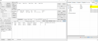

2024-02-14 05:08 AM
I am sure that the speeds are the same. It is 500kbps. My external clock is 25Mhz and the Can Bus feeds from the APB1 peripheral. APB1 peripheral is 42Mhz. I want to monitor just stm32. I send a 1 bit data from analayzer and I want to read the data on my stm32 in live expression. Here is a screenshot. You are true about the filter ı forgot the edit filters but yeah unrelated. And I attached a more simple code. The purpose of this program is receiving data from analyzer and observing in live expression. By the way, I am sure that the analyzer is working. Because I received many messages with analyzer from a device that transmit can bus message. and as I said My can bus system is working in normal mode with two stm32 boards

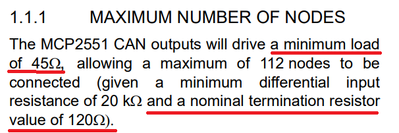

I use MCP2551 can transciever IC so I used 60 ohm termination resistor on my stm32 can transciever circuit because In according to MCP2551 datasheet , the termination resistor should be 60 ohm in the recommended connection but There is a 120ohm resistor on the analyzer
Could you please share a screenshot of the part of the MCP2551 datasheet showing that the termination resistor should be at 60 Ohm? I suspect you're are referring to the Test circuit figures ..
because this is what was said in it:
