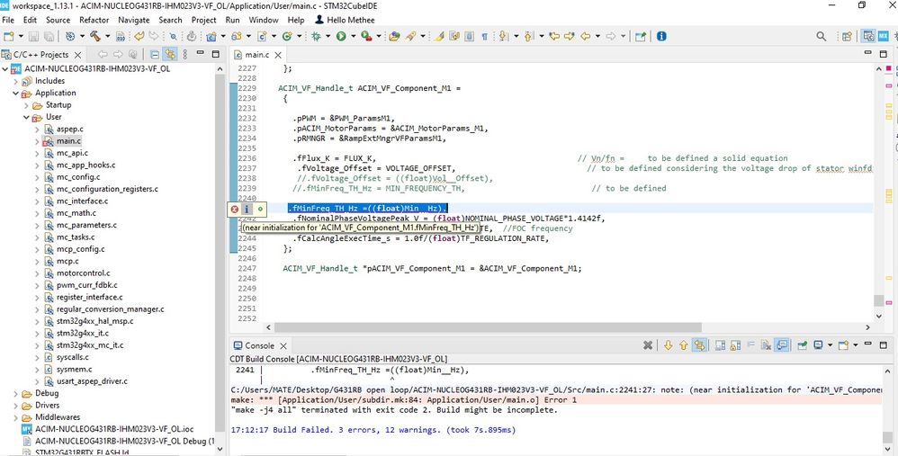

Dear Tesla DeLorean,
I need to read data from eeprom for change information in parameters of MotorControl Workbench 6.2.0 project.
But function parameters need to be const float or #define only.
Please help advise.
BR,
Methee
That is not a function, but a structure initialization. You need to learn the C programming language first before trying to deal with complex software development.
The compiler can't initialize the structure with a variable.
You should start with an empty structure, and write a subroutine to do the initial fill from your EEPROM, or whatever.
