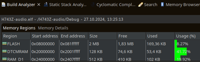

AScha.3
>my program output .elf file size is 1500kb
Maybe - but this is NOT the program to flash !
On my program here the elf is 4 MB ! But code to flash is 169 KB .
So first think, and look , what IDE tells you about code size etc. ->
Andrew Neil
@Dhatchaneswaran wrote:
my program output .elf file size is 1500kb. ?
As @AScha.3 said, the size of the ELF file is not the size of the executable code that goes into the microcontroller.
The ELF file contains a lot more information than just the executable code; therefore the size of the ELF file will be greater than the size of the executable code that goes into the microcontroller - and, therefore, than the size of Flash required.
The IDE build summary tells you the actual memory requirements. If that's still too big, what optimisation level are you using?
