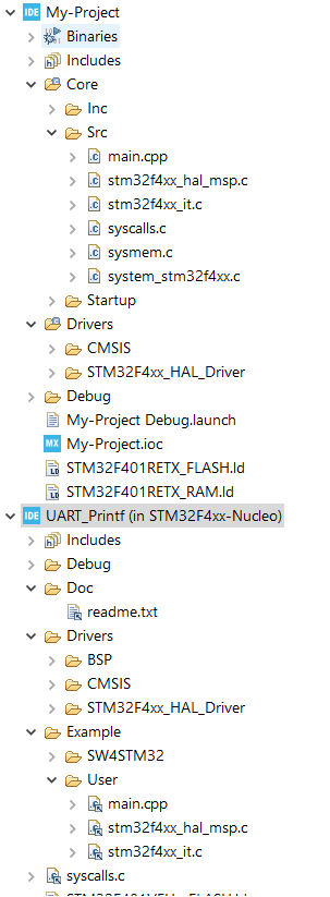

I've noticed a problem that is even deeper/weirder:
When creating a project from scratch, it works for me :
  • Create a brand new project (File > New > STM32 Project > Board Selector > F401RE and then Check C++ in the targeted language field)
  • In the CubeIDE navigation tree, right click on main.c and rename to main.cpp
  • Try to create a class in main.cpp => Compilation works :ok_hand:
But when creating a project from an example(File > New > STM32 Project > Board Selector) or opening an existing project, the manipulation (right click > Convert to C++ and then rename the extension of main.c to main.cpp) dosen't change anything. ie : I can see on the compliation log that main.c (even though I renamed it "main.cpp" through Cube IDE) is compiled with gcc and not g++.
Also, very weird : If I double check in the windows explorer, the file is still named main.c. It seems that for some project architectures, CubeIDE and the compiler doesn't take into account the renaming of the file.
Below, a screnshot (top project (My-Project) does compile with g++ and bottom project (UART_printf) doesn't compile with g++) ¯\_(ツ)_/¯
Any tips or thoughts on that ?
main.cpp has to be in the Src folder and not anywhere else, maybe ?
Has anyone ever succeded in converting an ST32 example to compile in C++ ?
Any program source (.c or .cpp) has to be in the SRC directory, and any .h or .hpp file has to be in the inc directory. Having said that, there are some tricks you can pull:
1) I do large projects with common routines acting as libraries
2) There is an application file and a configuration file (as well as screen files) generated by a graphics/project configuration program that handles linking buttons and screens, as well as generating conditional installs for optionally included hardware.
The trick, though, when having common sources to a number of projects is to use virtual folders. If (and when) you add/include a file to the project, the default behavior is to take a copy of that file and put it in the project's .src or .inc directory. Making (and including these) as virtual folders links everything back to a single copy.
Cube (anything) creates only a C file, not C++. Make any changes in configuration, and you add the new file main.c (and main.h). If you already have these, you overwrite the existing copies. If you've renamed your files main.cpp and main.hpp, then you don't change them, you simply overwrite or generate the .c or .h files. The problem is also that I'm using FreeRTOS, which is not (and may never be) C++.
Better to tweak the main file to call your C++ file and leave it at that.
I have the cube generated .c files calling a single statically named .cpp bridge file, which can call the application .cpp file. Any operating system calls are to C routines, and any low level calls to HAL routines are C++ to C, which works.
Since (in my case) the configuration.h file is project unique, it goes into the project's inc directory, as the application.cpp goes into the SRC directory. This also means that each project has an application.cpp and configuration.cpp, and they had better be kept separate.
Since I don't use their examples, other than perhaps reference, I've never really tried converting an example to C++. If all you're doing is examples, then as you create the project, I'd think the INC and SRC directories will load up. Each project needs a separate directory, of course.
So in short. Yes, everything seems to want to be (mostly) in the .src and .inc directories, either direct copies or virtual folders.
If you get to larger projects, all customized from a set of main routines, some of the above may be useful.
