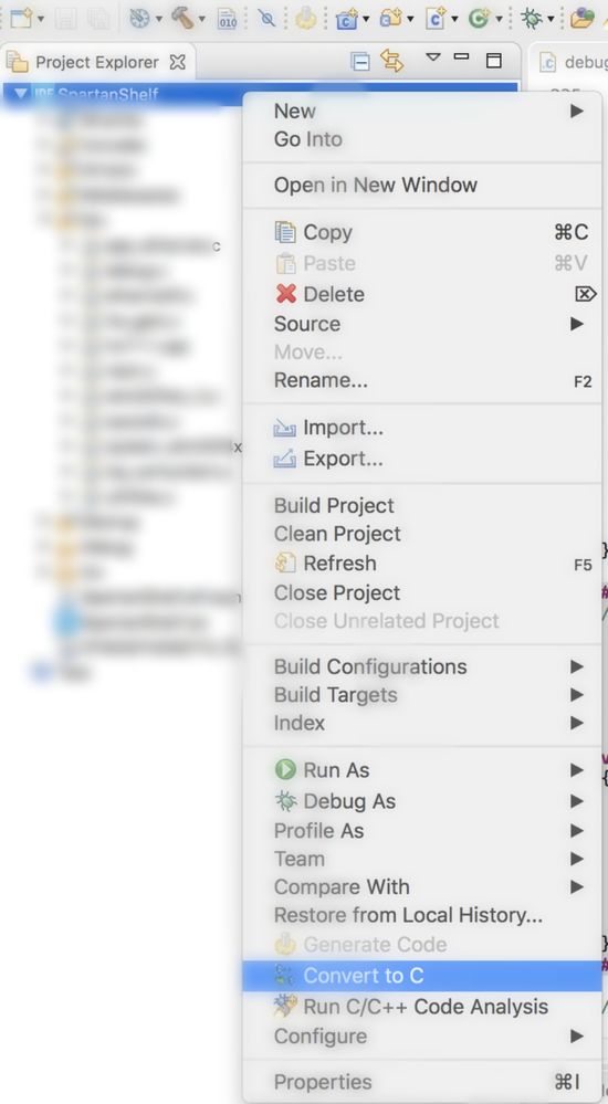

I know it is an old thread. But I had the same issue. I initially started with a 'C' project and then wanted to turn it into 'C++' project. This is how it worked for me:
1) Right Click on the project file and select 'Convert to C++' (Note: The image shows convert to C because I already changed it to C++)
2) Then I changed the main.c to main.cpp by right click on the main.c and click 'Rename'. This is important. DON'T change it manually. If you change using 'Rename' there shouldn't be any problem.
At least that worked for me.

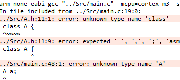

I still have issues with .h files not compiling correctly, i assume I have to name them .hpp? or .hh? I'll play with it now that i know.
Fahad Mirza
August 21, 2019
Are you talking about including '*.h' that belongs to a '*.c' file? If so, you need ---- extern "C" ---- like this:

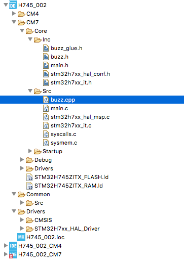

I'm running into this same type of problem here in September of 2020...
Create a working project through the wizard, even checked the "C++" language box, all the ST Cube / HAL code is still in C but that's fine, I can write a couple glue functions and keep the C++ stuff in my own sources.
I add a single .cpp file to the project, I put it in CM7/Core/Src ("buzz.cpp").
I added a header file ("buzz_glue.h") and the main.c is able to include it and see the prototypes for the C glue functions.
But my .cpp file never gets compiled, and the link fails.
I know it's not getting compiled because I put some garbage and an "#error 1" in the .cpp and it's ignored.

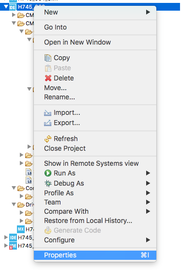

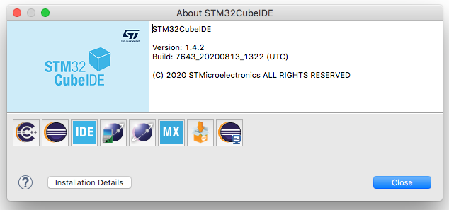

As an aside, the "Convert to C++" menu item that keeps coming up in these threads, is gone in 1.4.2, or I don't know which thing I actually should click on.
As an experiment, I went back and (through the IDE) created a new source file in Src, "dummy.c", and put an #error 1 in it, dummy.c does get an attempt to compile which fails.
So the symptom that I have is that if I add a .cpp file to this project, it is ignored. Which leads me to believe that I don't really have a C++ project. I don't know how to create one, and I don't see the option to convert C to C++ afterward.
So
a) even though I asked for a C++ project in the setup dialog, it's not really acting like one
b) the C side seems to see the header I added
c) the CPP file I added is being ignored
d) the "convert to C++" menu option is nowhere to be found
[UPDATE - I found the "Convert to C++" menu item, I had the wrong tab open, you only get it when you have "project explorer" open on the left sidebar and not "C/C++ Projects" - will see if that unblocks me. ]
