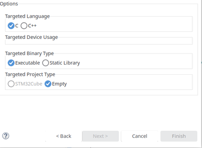

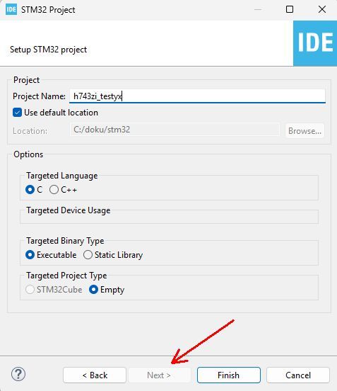

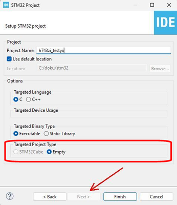

I encountered the following problem on two different computers with different versions of STM32CubeIDE. I select File->New->STM32 Project, then i select MCU or Board and click to Finish. Then pops up window called "STM32 Project" to fill up project name. Usualy there is "next" button to select another features, like which CubeFW version to use etc. But now, the "next" button is greyed out. Probably due field called "Target Project type" with greyed out option "STM32 Cube". When i hit "finish" button, IDE creates empty project without ioc file - in other words it does not open CubeMX to configure project.
I am not aware of interfering with the IDE in any way (plus I observed it on two independent PCs). I am including screenshots.

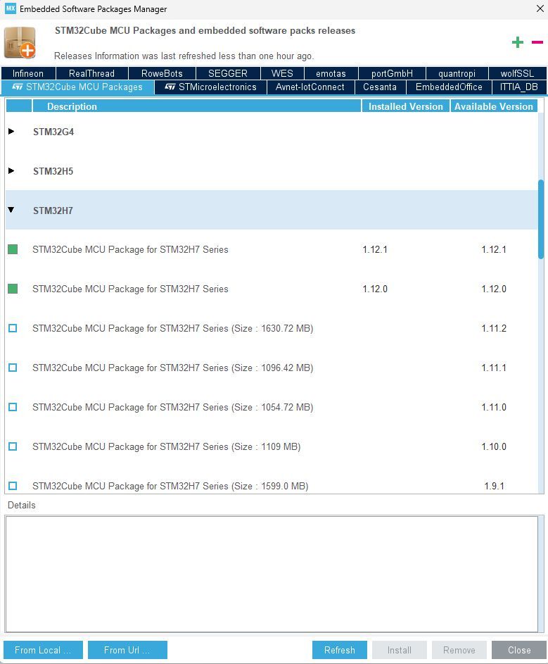

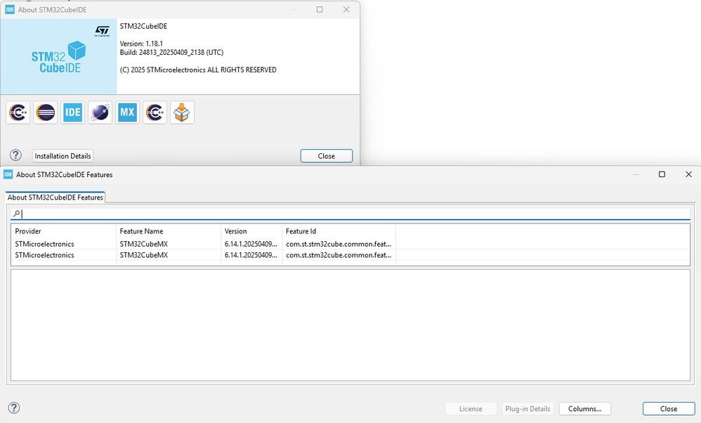

MichalVersion of CubeMX
CubeFW is actual
Empty project
missing option to use Cube

Can confirm this with v1.18.1 on Win11-Pro.

Maybe the key is that 'STM32Cube' is disabled in 'Target Project Type' - so it can only create an 'Empty' project?
