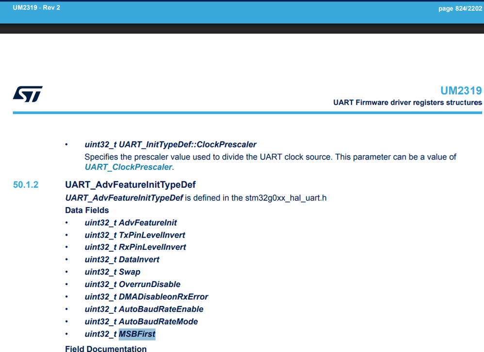

maybe this is it?
https://www.st.com/resource/en/user_manual/um2319-description-of-stm32g0-hal-and-lowlayer-drivers-stmicroelectronics.pdf#page=825

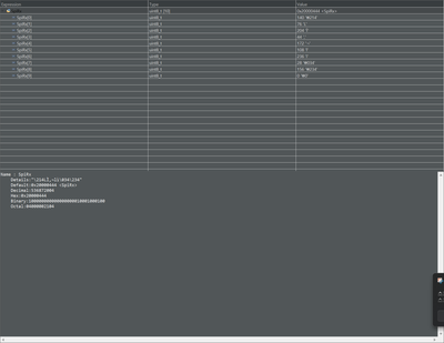

I've enabled MSB_FIRST BIT since the initialization of USART, but the output results remain unchanged. (It still seems to be operating as LSB first.)
Is there any way I can try it now?

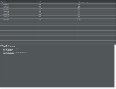

Below are the buffers I sent to USART(UsartTx) and the buffers I received with SPI(SpiRx). In CUBE MX, I changed SPI to MSB First.

From the RM, about the MSBFIRST: "This bitfield can only be written when the USART is disabled (UE=0)."
So don't set this bit after init(), rather set the AdvFeatureInit struct members as usual.
