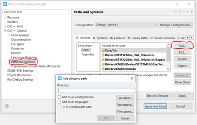

Kmax18
Senior II
It has been a while since your question, but hopefully my answer helps somebody else:
In the main menu go to Project -> Properties -> C/C++ General -> Paths and Symbols. Then add your folder.

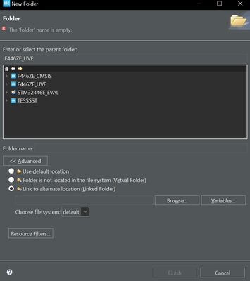

Rim LANDOLSI
Hello @zqizh.1 ,
In order to add an existing folder to STM32CubeIDE project , try to add it using an advanced link. So, Right click on the existing project, then, click on "New Folder" and use the option "Link to alternate location" as shown in the screenshot.
Also, include the path to the project via "property->c/c++ build->setting->toolchain->mcu gcc compiler->include paths".
