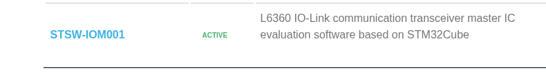

I bought a NUCLEO-F401RE and the STEVAL-IOM001V1 evaluation board to experiment with the IO-Link protocol. I’m having trouble importing STSW-IOM001 into my project. According to the documentation, it’s supposed to be opened in SW4STM32, which is an older tool. I’ve followed all the instructions I could find for importing it into STM32CubeIDE, but nothing has worked. Do you have any suggestions?

And what about the ->
You tried to use it ?
