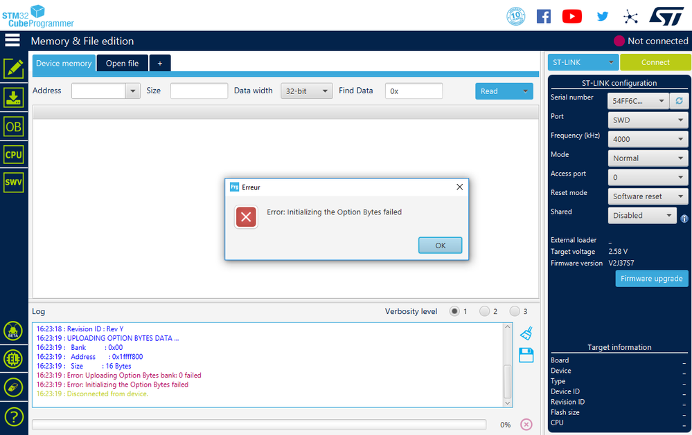

Hello, I hope someone had an answer to this problem since it was posted a year ago. I am currently trying to program an STEVAL-ESC001v1 board with an STLINK V2 ISOL probe. The IDE I use is the STM32CubeIDE. Before that, I used a regular STLINK V2 probe and the debugging of my program worked perfectly. Ever since I switched to the STLINK V2 ISOL (for isolation from power), I have been getting these errors on the console :
STMicroelectronics ST-LINK GDB server. Version 5.8.0
Copyright (c) 2020, STMicroelectronics. All rights reserved.
Starting server with the following options:
Persistent Mode : Disabled
Logging Level : 1
Listen Port Number : 61234
Status Refresh Delay : 15s
Verbose Mode : Disabled
SWD Debug : Enabled
InitWhile : Enabled
Waiting for debugger connection...
Debugger connected
Target is not responding, retrying...
Debugger connection lost.
Shutting down...
I tried using the STM32CubeProgrammer software, but It seems like the ISOL probe doesn't recognize the target :
Can anyone help me out with this issue ? Thank you very much
