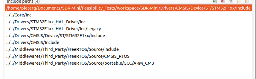

The files are in the filesystem, but for some reason I had to give an absolute path to the IDE. Below are my current PATHS:
_legacyfs_online_stmicro_images_0693W00000bkMWOQA2.pngThe problematic header file is in that directory.
PGild.1
Is the solution then to "always" delete that USB line?
Rim LANDOLSI
As I did previously note the defines are generated from STM32CubeF1 firmware that's why they will be regenerated in this file "../../Drivers/CMSIS/Device/ST/STM32F1xx/Include/stm32f103xb.h" by CubeMX when making any other changes.
