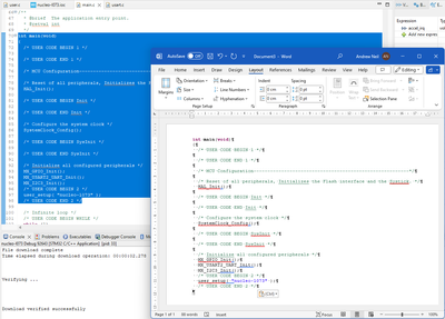

As a workaround, if you copy the selection & paste into Word it will retain the monospaced font and syntax highlighting; eg,
This has the advantage of giving you much better control over pagination, etc ...
