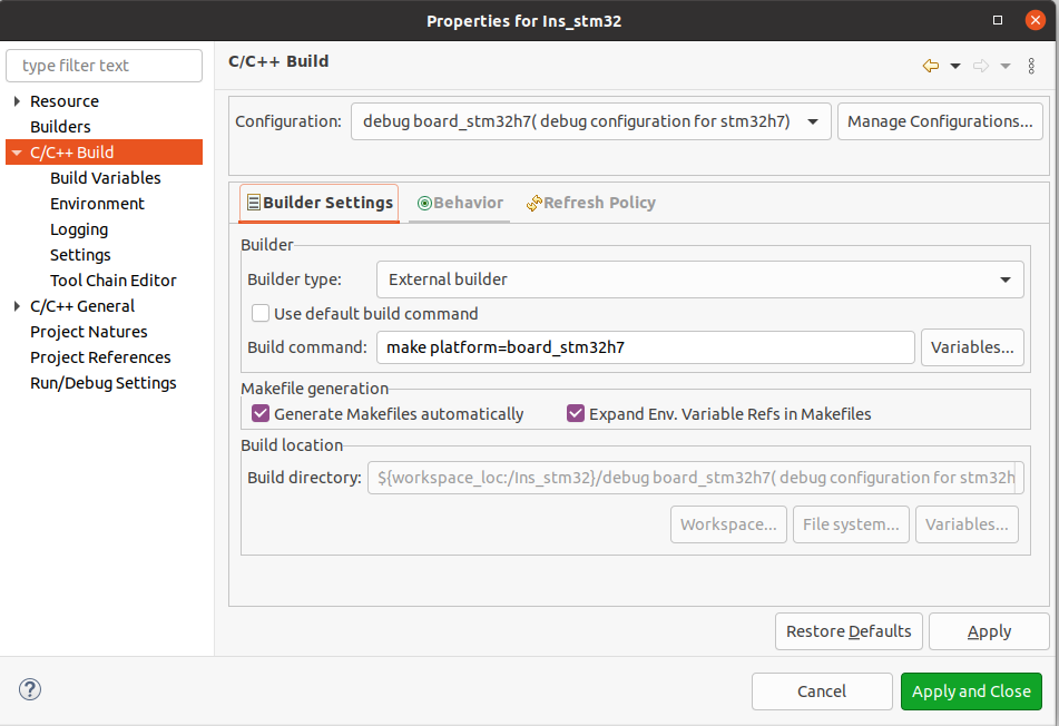

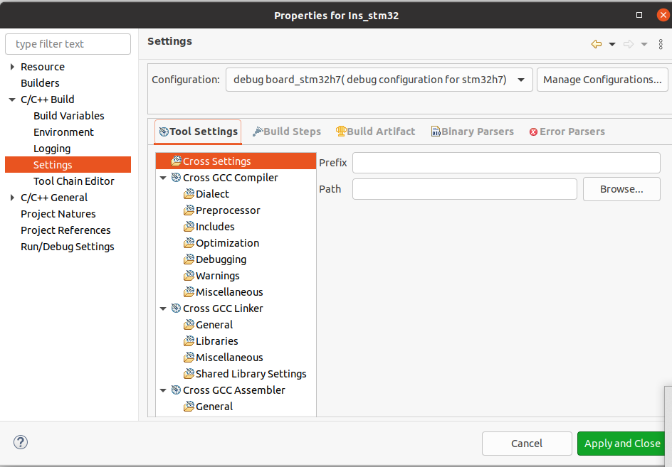

Hi @mattias norlander​
Your advise unfortunately does not work here on Ubuntu...
We have an existing makefile project.
Checked "Generate Makefiles automatically".
But this does not enable " MCU Settings"
0693W000007ZvQOQA0.pngPlease advise ? Is this working only on Windows or only for newly created makefile projects?
Thanks,
Pavel
Answering my own question...
* The trick to specify the MCU requires to create a new CubeIDE makefile project, as in the Mattias' post above.
* Folks who have any other Eclipse makefile - based projects, can take them and *** **** up their *** ****.
* The binary should be located under the project directory. Could not make the GUI recognize any build variables or linked resource paths to specify the binary to debug.
Anyway this is definitely a progress.
Thanks!
-- pa

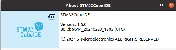

So I installed Cube 1.6.0, used CMake to create a makefile project, then proceeded with the steps @mattias norlander​ gave.
This does give me a project that I can build from the CubeIDE, and I can create a debug config and start a debug session.

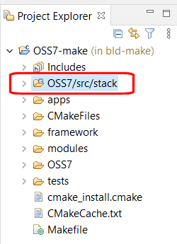

I tried adding a 'Source Folder' to the project:
0693W000008wdz6QAA.pngNote the '>' indicating that it can be expanded & has stuff beneath.
But, after I added the Debug Configuration, the 'Source Folder' became empty:
0693W000008wdzQQAQ.pngNote how the '>' has gone - there is now nothing to expand!

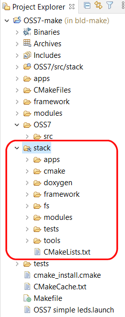

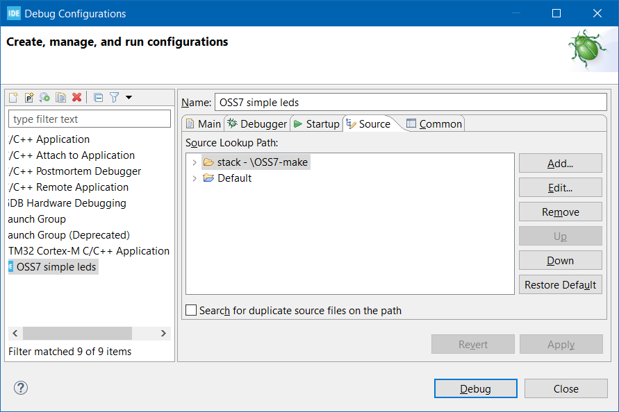

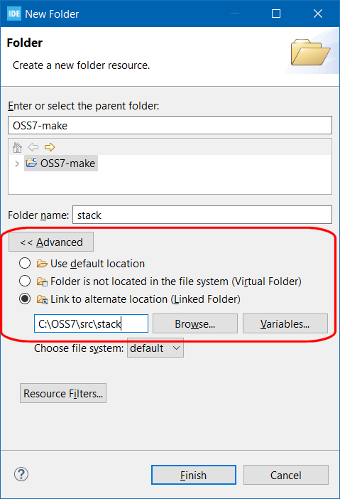

So, instead, I tried a just a 'Folder' - not a 'Source Folder' - and used the 'Advanced' options to point to the source files location:
0693W000008we0OQAQ.pngWhich gives
0693W000008we3SQAQ.pngand I could add that as a 'Workspace Folder' to the Debug Config:
and that does seem to enable the debugger to find the source files.
Perhaps someone could explain the difference between a 'Folder' and a 'Source Folder' ?
perhaps I should add that the structure of the OSS-7 tree is like this:
OSS7 ---+--- cubewsp                    << folder for the CubeIDE Workspace
        +--- src ----+--- stack ...     << the stack source tree
                     +--- build         << the makefiles created by CMake
so the source files are not "beneath" the makefiles - they are in a tree alongside them
