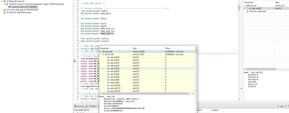

I'm having trouble getting ADC to work, and I feel like I've tried everything to get any kind of result. I'm starting to think that this individual chip is having issues but I want to rule out any user error before I replace it. It seems to never store any kind of data and always just returns 0 as well as an error code 1. I've tried all ADC modes at this point and it never provides any kind of data.
Here are the facts;
I'm using a STM32H743ZIT6 on a custom board and im programming with STM32CubeIDE using a STLINK3 and SWD.
My board uses a 48 Mhz crystal that is configured inside the IDE and seems to work fine since I have other functions of the processor working.
I have a display connected to SPI that is working fine.
I have a voltage divider connected to PA1 that provides 2V up to 3.3 V ( this is verified) and I'm trying to measure it, I have it enabled as an ADC input with DMA.
When I do an adc error call, It gives me error 1, meaning there is an internal error.
Register ADEN is enabled, However, ADRDY will not and cannot be set. Every time I try to set it, it just goes back.
The ADC clock mux is greyed out when I configure the chip in stm32cubeide. When I highlight it, it just tells me to enable ADC, which i have. I've tried turning on multiple adcs but it remains greyed out, not sure if that's normal or not.
Attached is my entire code library, It's mostly cube generated code with the addition of the display code. Please let me know if you need anymore information and any assistance is appreciated.

> uint32_t value;
> HAL_ADC_Start_DMA(&hadc1,value,3);
Should be getting a error when you compile this. You're passing an (uninitialized) integer instead of a pointer.
Unclear why you're storing 3 ADC values into a uint32_t. Probably going to be an overrun, if it were to work at all.

Thanks for your reply! I dived a bit more into how to properly store DMA values and ended up using this source, https://www.digikey.com/en/maker/projects/getting-started-with-stm32-working-with-adc-and-dma/f5009db3a3ed4370acaf545a3370c30c
I used their method and came up to this conclusion
0693W00000Kd2qcQAB.pngThe error flag for ADC is still at 1 and the ad_buf just sits there with 0s forever never triggering a half filled callback. Any other suggestions would be greatly appreciated.
Here is the new relevant bit of code.
