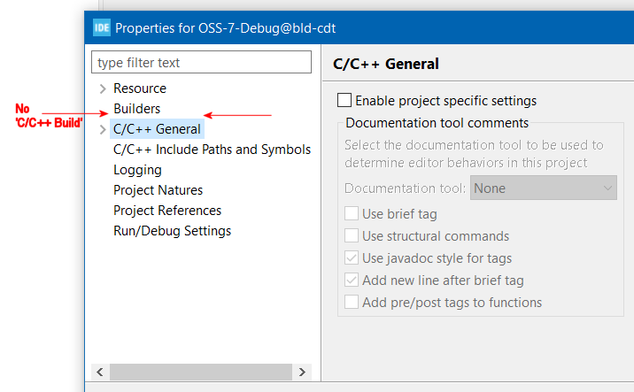

I just tried it with importing an Eclipse CDT project: that finds all the source files OK, and builds OK, but the Project Properties doesn’t have the ‘C/C++ Build’ page (it comes between ‘Builders’ and ‘C/C++ General’ for a makefile project):
So it remains impossible to debug a "plain vanilla" Eclipse Project in Cube IDE.
As @Pavel A.​ noted above, I think that's an issue for people who don't have a makefile project to start with - irrespective of any misgivings about how I created my particular project.

‎2021-03-28 7:22 AM
Hi Pavel,
Did you press the Apply button after ticking "Generate Makefiles automatically"?
WBR Alec
‎2021-04-30 4:02 AM
Hi Andrew,
About folder vs source folder.
In your project "OSS7-Make" the very project root folder is setup as a "source folder". It means the that the build system will scan for c-files recursively from project root.
It may be more common practice to instead define certain folders contain c-files and only let build system scan these. This is what the "source folders" let you do. If you add a regular "folder" it is not considered by the build system when scanning for c-files.
There is however always a BUT... Here goes: BUT, if you have the project root folder as a source folder, then all child folder MUST be only "folders". Otherwise Eclipse/CDT will be confused and visualise a folder named "stack" as "OSS7/src/stack".
Old Eclipse/CDT bug... Not something we plan to try to fix, so many other more important things where we can contribute in CDT...
You can determine if a folder is a "source folder" or a normal "folder" by looking at if the icon is decorated with a small blue/white C. Your screenshots provide good examples with the project root vs the OSS7/src/stack. This folder should be re-created as a normal folder...
Second issue:
"If you have an Eclipse project, you still can't get that into CubeIDE and get debug working."
It should be possible to make this work too... I have this working on my machine. Or I missunderstand the use case in some way.
So my understanding is that you have a normal Eclipse/CDT vanilla project. You want to build and debug it in CubeIDE.
It should work both with managed (auto-generated makefiles) and unmanaged mode (relying on your makefile).
Could you describe how you imported the project in CubeIDE? In your case you should be doing just a file > Open projects from filesystem... should work!
If relying on your own makefile you have to perform the "little stunt" in step 4.1-4.7...
If relying on managed build with auto-generated makefiles you will still need to select our toolchain integration and the correct MCU to be able to debug.
