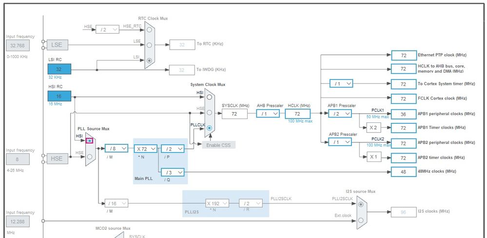

Working with the STM32F411 on the ST F411 Discovery board, we have set the speed to 72MHz using the HSI as the PLL source.  The register values are as follows:
RCC->CR = 0x03005C83
RCC->PLLCFGR = 0x23001208
According to Cube, this configuration is invalid:
In fact, there seems to be NO clock speed we can find that won't flag the configuration as invalid if HSI is the PLL source.  Although the code appears to run correctly and there haven't been any timing issues experienced we want to check if there is some additional clock setting someplace that needs to be used to stop Cube from flagging this as an error.  Current version of cube is:

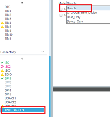

Are you enabling USB in your project? if not disable it from here:
If you need USB function, you need to use HSE with an external crystal.

Could you please share the error/warning message CubeMx is showing for that configuration?
As you can see in the original attached image, there is a red box around the HSI selection at the PLL Source Mux input.  This box is there any time HSI is chosen as the input no matter what /M /N /P settings we pick.  The tool-tip that pops up when you hover over merely says "PLL Mux should have HSE as input".
Yes, that seems to be the issue.  The curious thing though is that USB functionality appears to be correct regardless, so we will need to check this again.  Our USB stack is a 3rd-party project from github and their clock configuration code is as follows:

I’m not expert of usb but as I said previously you need to use HSE for usb either in crystal or in bypass mode.
Yeah - the HSI is not stable enough over temperature and voltage for the USB spec.  It may work at room temperature in your particular setup, but that is no guarantee it will work elsewhere under different conditions.
