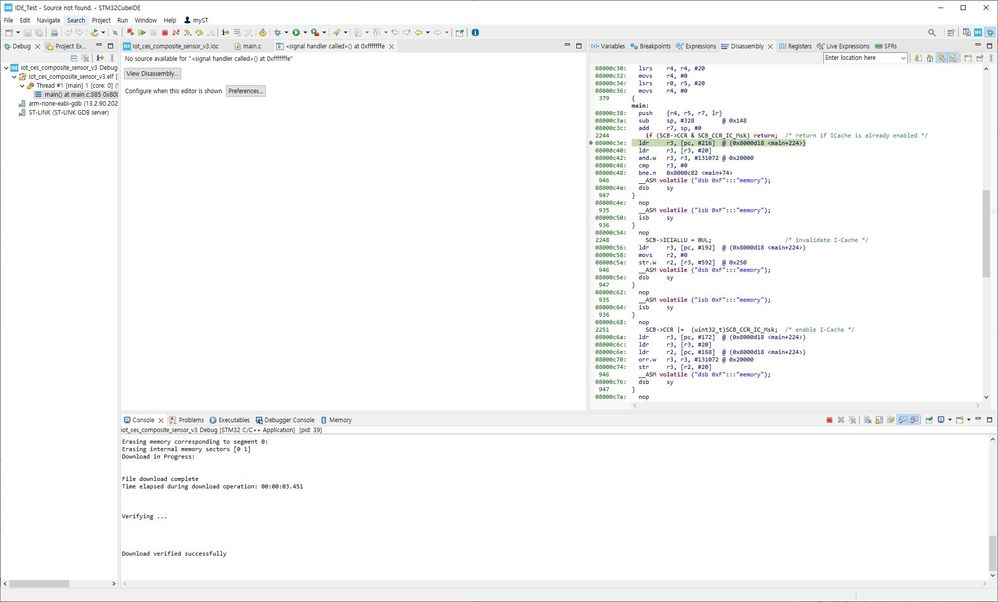

I was making a project with CUBE IDE and compiling it on the board, and I got this error while compiling the project I was doing on the new board.
No source is available for "Call Signal Handler"() in 0xfffffffe.
I'm sure they're using the same CPU
I can't compile it because it's STM32 ST-LINK
I don't think there will be any problems with the code or MX settings because if I modify the code on the existing board, the project will also change well.
Even if I create a new project and add the above code, I get the same error, so I can't compile it
I want to solve this phenomenon, how do I solve it?

The same error occurs in the above simple code.
How can I fix this problem?
stm32 : STM32H743XIH6
Error image
Current state
2 REPLIES 2

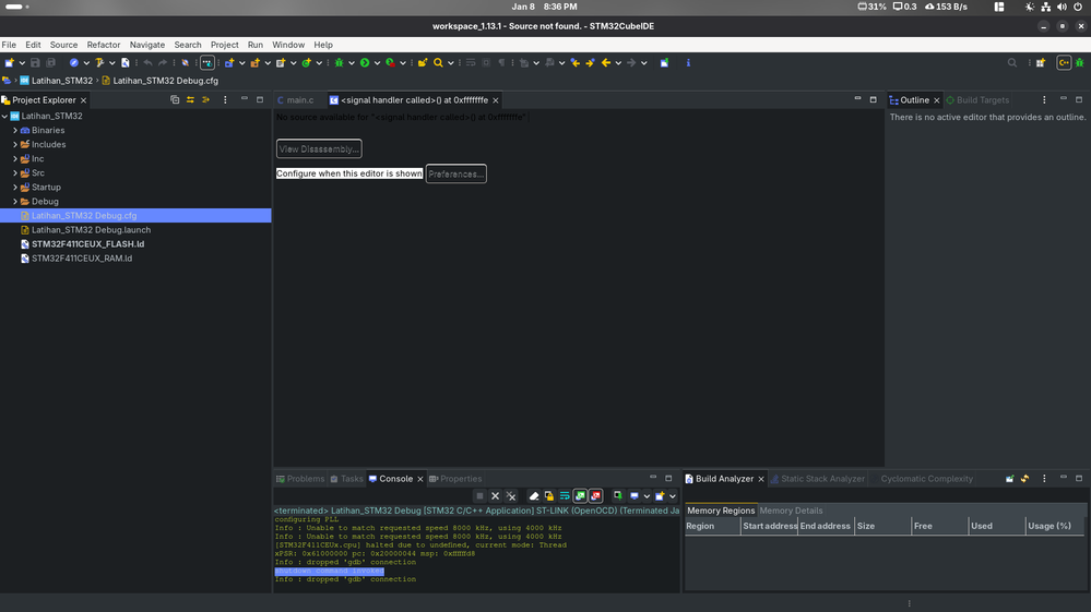

I'm experiencing the same thing.
But mine can execute the code and experience changes in my MCU, such as LED blinking, and there are no error messages at all.
Is this a problem or is that how it works?
What is this usually called?
