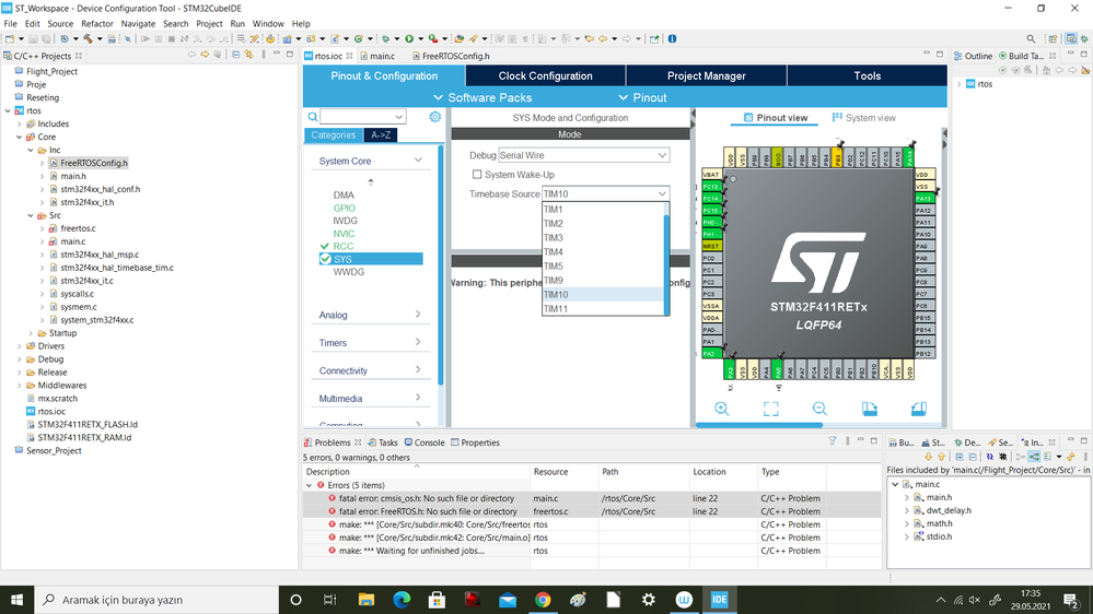

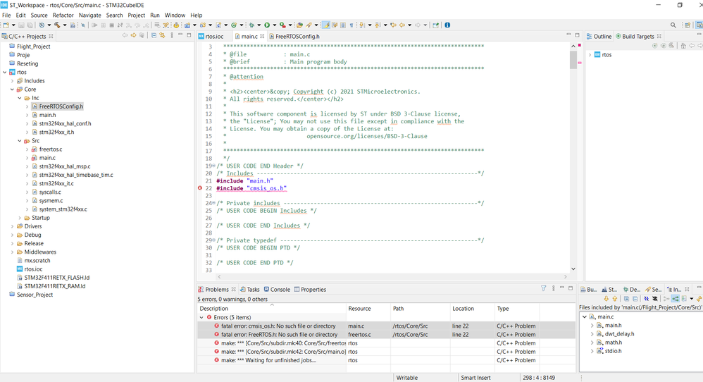

i was watching this tutorial:
https://www.youtube.com/watch?v=OPrcpbKNSjU
Differences between video and what I do:
my card is stm32f411re nucleo64 and i select the tim10 because the tim6 was not visible to me
these are pictures:

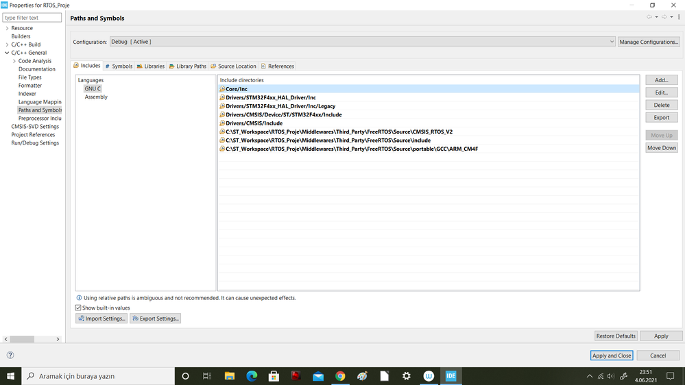

Please check the include Paths
 ==> Go to Project options ->C/C++ tab->Include paths and add new paths to your include directories
 Imen

hello, thanks for your reply, sorry for the late reply, as you said, I checked the included paths from the project options and as you can see in the picture, I added three new paths and the errors I got were resolved, but this time other errors appeared.

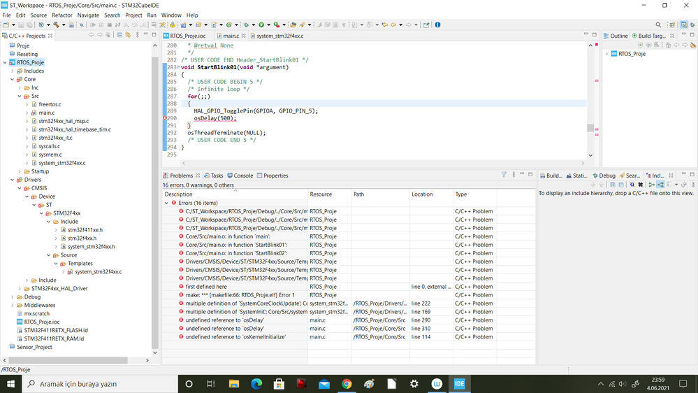

these are the new errors i got

I checked the undefined reference errors about stm32 on the internet but I couldn't find anything useful

Well, then learn using the Internet first... The "undefined reference" error means that there are no actual function implementation, which typically means that the corresponding *.c files are missing or not compiled.
