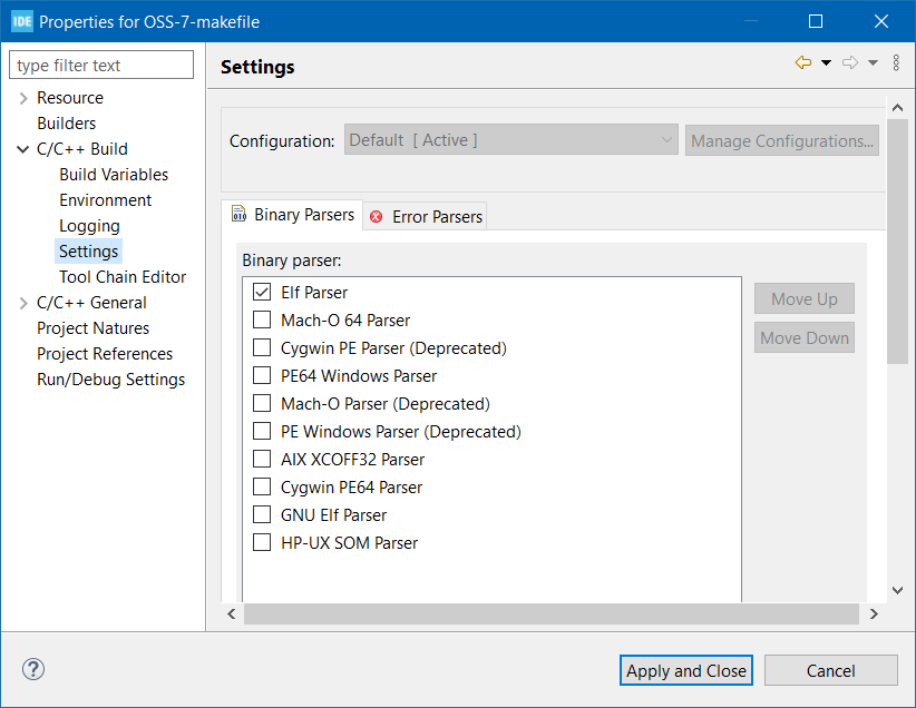

It seems so.

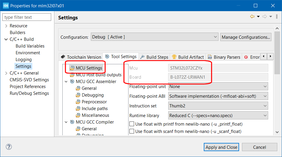

In a genuine, "native" STM32CubeIDE Project:

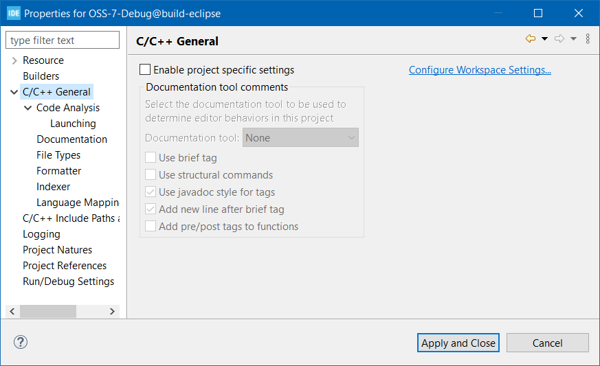

0693W000007Ek8MQAS.pngIn the imported Eclipse project, that stuff is nowhere to be seen:
0693W000007Ek8vQAC.pngthere isn't even anywhere to enter it manually
in the imported makefile project, the C/C++ Build > Settings section does exist - but there are no MCU settings:
0693W000007EkDgQAK.pngand, again, nowhere to enter it manually
