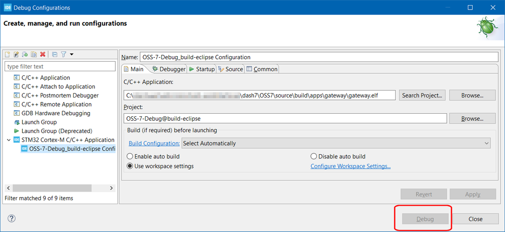

But I can't seem to create a Debug configuration that works - the 'Debug' button always remains greyed-out - even after pressing 'Apply' on any changes:
So what's going wrong?
Why can't I use this Debug Configuration?
What is keeping the 'Debug' button disabled?
The Target is a B-L072Z-LRWAN1, it is connected and a 'Scan' on the 'Debug' tab will read its serial number.

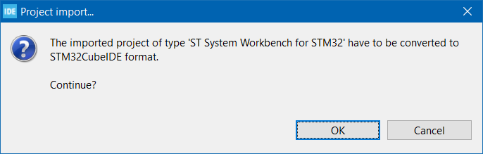

Interstingly enough, when I open a .project file for SW4STM32 (as found in many ST examples), the CubeIDE recognises that a conversion is needed:
but there was no such warning in this case.

I create a Debug Config, and fill-in the details on the 'Main' tab - but 'Apply' or trying to go to any other tab gives:
I don't see where to specify the MCU target in any of the Debug Config tabs - maybe it's elsewhere ... ?
