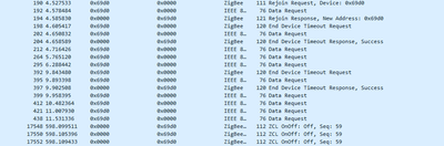

‎2024-09-30 3:59 AM - edited ‎2024-09-30 4:04 AM
Please find attached a PCAP with selected packets between coordinator (0x0000) and end-device (0x69d0). As we can see on the picture below (full file attached), the device request seems to timeout for whatever reason.
Regarding the breakpoints, I didn't noticed any issue. The sequencer goes back to UTIL_SEQ_Run once the second callback is issued and does not seems to be blocked, looping inside UTIL_SEQ_Run. But as we can see on the PCAP, it does not responds to the On/Off command.
Regards,
‎2024-09-30 4:40 AM
Could you please share the network key to decrypt the packets ?
Regards
‎2024-09-30 4:41 AM
Of course:
d7:35:01:45:be:da:a9:b0:7a:0c:95:80:c3:6c:bb:bb
‎2024-09-30 5:03 AM
Thanks for the information.
I now understand the reason why the device does not receive all the ON/OFF commands sent from the coordinator.
Indeed, the device is configured as a Sleepy End Device and goes to the sleep mode most of the time and wakes up after the End device timeout to perform the data poll request, during the sleep period, the SED has the radio off and can not receive any packet over the air.

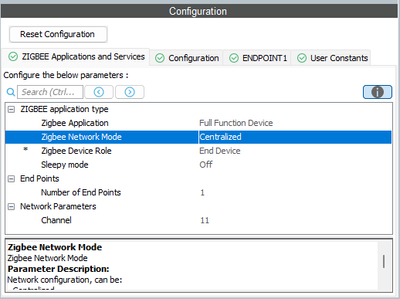

My device is defined as an "end device" but sleepy mode is "off". I tried with Device Role equal to "router" but the issue is still present.
Nevertheless, knowing that the device goes into sleep mode is a good track. How do you see that ? I also tried to switch from "centralized" to "distributed" but the issue is still there.
Thank you
‎2024-09-30 6:10 AM
The device remains sleepy even when disabling the sleep mode on CubeMX, we are working on this issue and it will be solved in next release.
