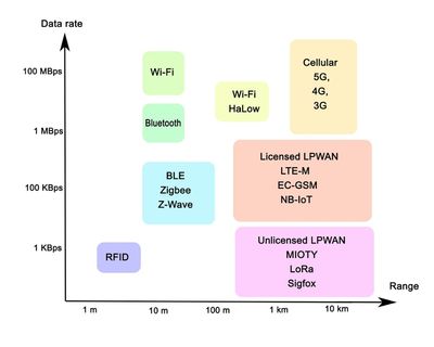

Thank you for your answer, I have hundreds maybe thousands of router (it can be thought 1000). I wanna send photo from every routers to coordinator when my sensors triggered. Is it possible to control this data traffic.
Andrew Neil
October 22, 2024
As @Peter BENSCH said, this is really not what Zigbee is designed for - why did you choose Zigbee?
But, anyhow, as far as the network is concerned, it's all just data - so long as you abide by the protocol rules, the data will flow.
But it's highly likely that thousands of nodes all sending huge files (photos) will simply overload the network's capacity.

I chose this due to the mesh structure and the high number of connected devices. Do you have any other protocol recommendations that would be suitable for the structure I mentioned?
Andrew Neil
October 22, 2024
WiFi would seem an obvious choice?
Why do you particularly need a mesh?
from: https://www.emnify.com/iot-glossary/guide-iot-protocols
Not sure that their depiction of "BLE" accounts for the v5 2M PHY ?
Also not shown on that (too new?)  is the 5G DECT NR+
https://www.5gtechnologyworld.com/the-first-non-cellular-5g-standard-dect-nr/
https://www.dect.org/nrplus
Maybe also look at Matter?
