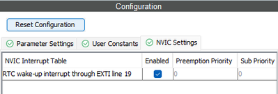

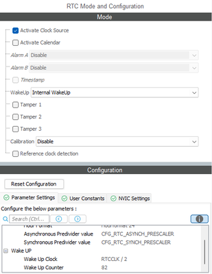

Yet, when I configure the RTC WakeUp as shown in the screenshots at the end of the post and add the call shown below to my initialization code in the main method, the intterupt is triggered exactly once and not periodically.
HAL_RTCEx_SetWakeUpTimer_IT(&hrtc, 82, RTC_WAKEUPCLOCK_RTCCLK_DIV2);

The configuration for the RTC looks as follows:

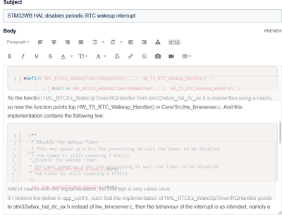

As a side note: The UI for inserting code snippets into the forum post is broken:
When I drag a code snippet with the mouse, a semi-transparent copy gets attached to my mouse and if I left-click, I can insert a ghost of this snippet in the UI:
The only way to dislodge the ghost from the cursor is to click on preview in the upper right. When coming back from the preview, the ghosts are still there though. Im using the latest Firefox on Windows 11...
