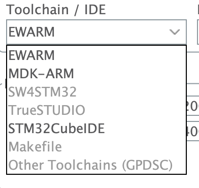

I'm trying to create a Makefile-based project for the STM32WL55CCUx microcontroller but it's not possible.
Why is it disabled? Is there a workaround?

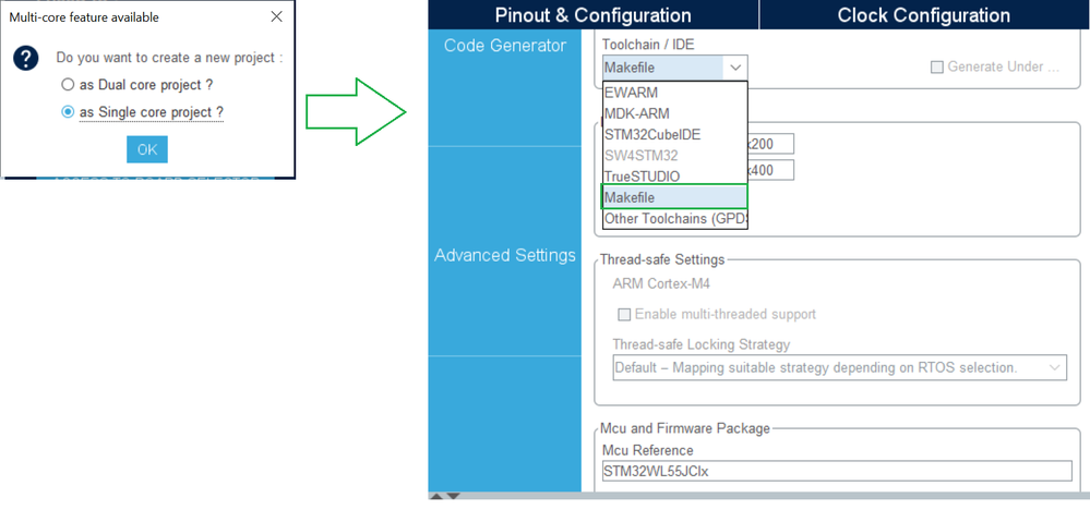

Actually Makefile toolchain (as well as TrueSTUDIO and GPDSC) are not available for multicontext SOCS.
Otherwise, starting the project based on STM32WL55 as Single Core, it will be possible to select Makefile as toolchain :
0693W00000AOswvQAD.pngHope this answers your question. If it is the case, please click on the Select as Best button on my reply in order to help other members of the community find the answer more quickly.

In which moment ask STM32CubeMx to choose dual/single core new project?
If you choose File -> New Project and search for a part that has dual cores (e.g. stm32wl55cc), STM32CubeMx asks you about dual/single core right after you have double clicked the chosen part

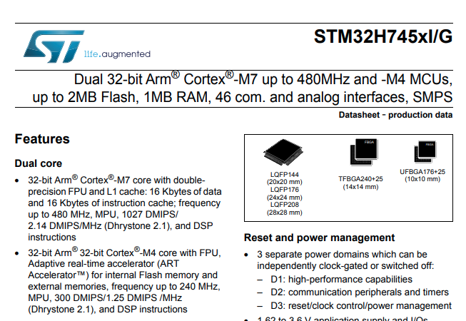

Where does it say stm32h745zi is dual core? I cannot find that information anywhere.
Left column, features - dual core.
I wonder how I managed to miss that information.
