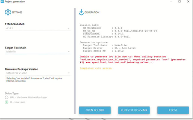

The generation of ioc files in the stm32f407igt6 dual-motor 3-resistor mode failed
starmlee
The single-resistance mode of the current sensor can generate successfully, while the three-resistance mode fails to generate
Software version:
MCSDK 6.4.0
CUBEMX 6.14.1
CUBEFW 1.28.2
log

2025-07-04 10:29:26,707 DEBUG [IocGenerator.process] F:\06.Code\FOC\STMC2M\STMC2M.ioc ioc file: Generating
2025-07-04 10:29:26,707 DEBUG [IocGenerator.createOutput] Generating file from template templates\wb_ioc_template.ftl
2025-07-04 10:29:27,363 ERROR [LineInfo_to_exitCode.manage_IocGenerationError] Unable to generate ioc file due to: When calling function "add_extra_regular_cnv_if_needed", required parameter "cnv" (parameter #2) was specified, but had null/missing value....

Hello @starmlee,
As mentioned in MCSDK6.4.0 Release Note documentation available through "Workbench tool">About>Documentations":
For STM32F4xx Dual Drive (as STEVAL-IHM039, the only supported ADC configuration for both stages is: 2ADCs (ADC1-ADC2).
If you agree with the answer, please accept it by clicking on 'Accept as solution'.
